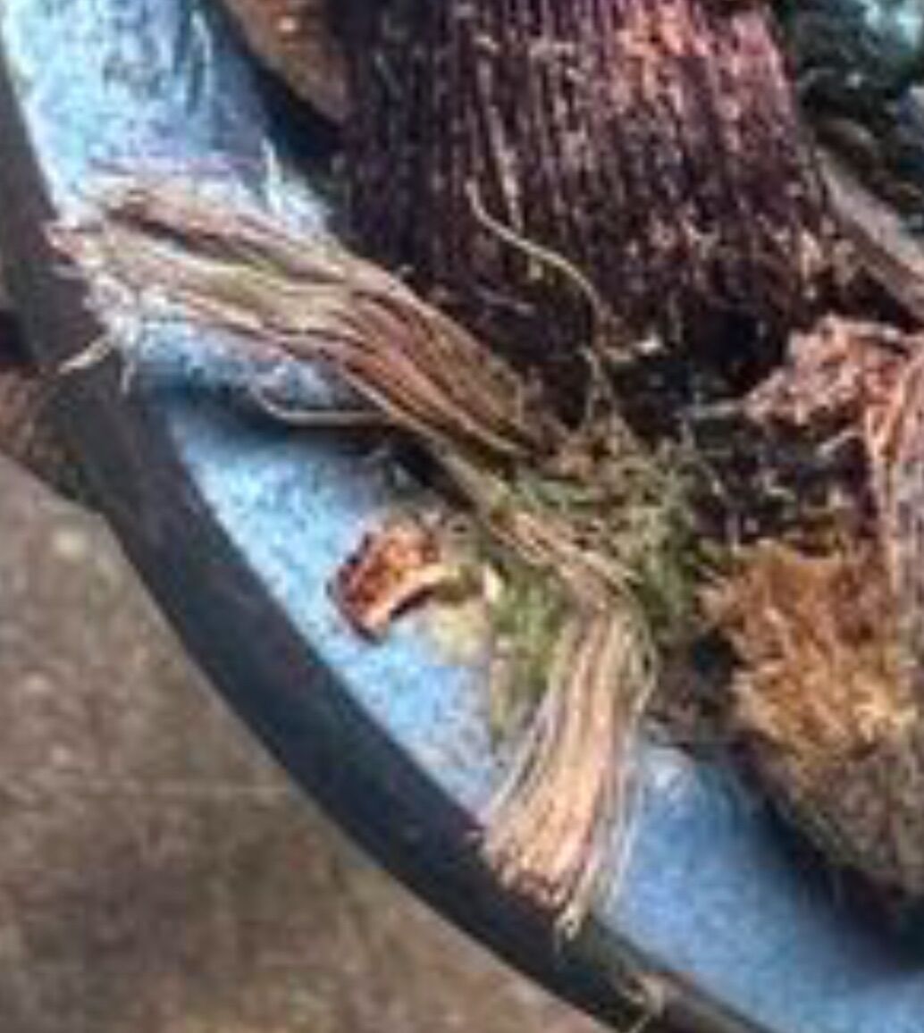

Are these your leads? If so you should fish the leads out other side and attach new head-wire directly to where the single core magnet wire meets.
So next steps are to replace twisted cloth cord the. Add varnish.
I will work on this tomorrow. Need to order the kit you showed earlier. You're a life saver.
Yeah, where your leads were, you were reading the windings that are coated in clear insulation. You shouldn't get a reading there.
Get a resistance reading on the old motor leads only.
